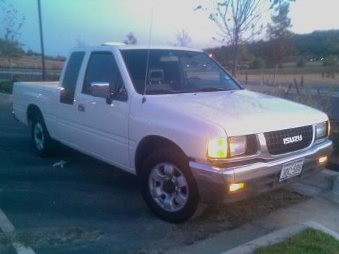

2wd 4wd will interchange....up to 95...some 95.5 Rodeos also...96-up have heavy backspacing for the wider front and rear suspension so becareful on say 96-04 Rodeos/Amigos/Axioms/Troopers.....the 98 4runners, MIGHT fit but they WILL sit inward abit. If they are the split 3 spoke, they have 15mm offset (about 3/4" more backspacing) or if you have the 6 spoke 17"......those are like 35mm offset, and they tuck inward. i have both sets and know. The split 3 spoke (common on the 90s tacomas and 4runners) fit NICE, alittle inward but about 1/4" and you dont see it...i have to order mag lugnuts to put them on my Isuzu but i test fitted them first...really bought them for the NEW 31" tires on them :)
to give you an idea, and YES the truck IS getting repainted.....

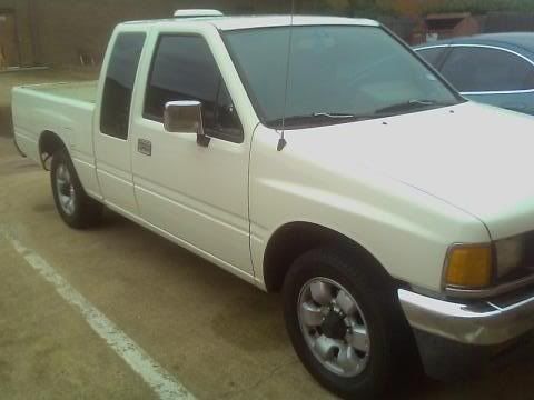

hey just a heads up and not that it really matters at the end of the day but those frontier rims didn't come on just the supercharged ones...... And them and a design very similar to them came on the hardbody p/u's that will fit also :wink: see :D ---->ImageImage too bad that no insurance havin' a--hole rear ended me in traffic.... :roll: traffic was stopped on the highway he rear ended me i was in neutral and didn't have my foot on the brake so i hit the person in front of me you can see on the one pic the front bumper's tweaked a little :cry: but anyway yeah those rims came on the hardbody's and there are some other one's that look alot like them but the spokes are more thin they'll fit too.....

sorry i just re-read my post to clarify though the one's on my truck are the same as the frontier one's but came off of a hardbody.... and yeah the rims were factory on it i know the guy i bought them from.....

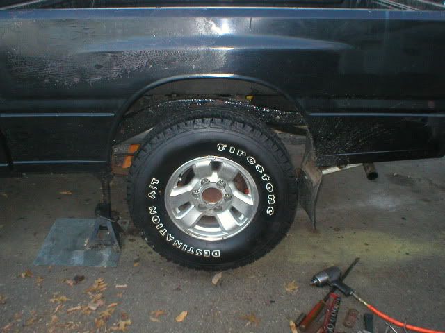

And of course, Isuzu wheels fit right fine too...my example....
