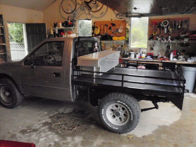

I built this with a Hobart 125 using flux core wire.
I did not see a lot of splatter or mess.
Just plugs into 110v house current.
Great little welder!
